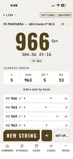

Here is what shows up on the app for me. I’m guessing that you need to go to screen settings and select detailed. If you have the other setting selected, it will only show velocity. FX definitely hurts in the documentation department.
Well I thank you for your help. I now receive fps and FPE, yeah! But no total on FPE or Statistics/Expand or last 5 shots to look at as needed or the remaining voltage in the FX. Just came off the range and Realized if you push New String all data from last string is lost or just hiding. It’s not there.
Thought this new FX might improve my experience but just confirmed the Origional was programmed better for what I like to do. I’ll just go back to a good program.
Thank you once again for your help.
