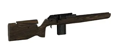

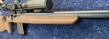

I have been working on a new stock for my FX DRS for a while as time as allowed. Getting closer to making wood chips on it. One of my development steps is printing the stock design and checking ergonomics and appearance before I CNC program and cut wood. Because of printer size limits the PLA stock is printed in sections and just glued together. It works for what I need it to do.
CAD model.

What do you think? Like the lines??

It looks really good and practical especially if using a rear bag. I think with the bottom of the butt stock having all that wood that I would put an off-hand notch there to pull in the stock to my shoulder. I am not sure of the actual name for that design feature. Great job as is though, and you get to make it fit yourself perfectly, which is awesome!
I know what you are talking about for the off hand butt grip. I plan on developing a couple of other designs for this rifle, so maybe in a future design.
Yes, I could 3D print a fully functional CF composite stock and "permanently" bond it together using pins at the joints. I actually have printed pins and holes at the joints for alignment. The tech is really awesome.
For a full synthetic you could make the bottom foregrip flat too, so you could just screw on a full length Arca Swiss plate very easily. The world is your oyster with that technology. I am really curious to see your final results. Nice work!
Thanks,
The forearm is flat and I will inlet and install a flush M-lok panel on the bottom. Then all kinds of things can be mounted to it.
