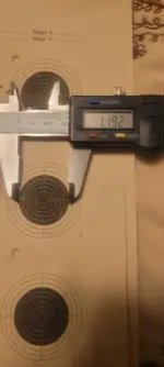

Hmmm but you were getting excellent groups with the lighter & midweight slugs!? I get that you want it to shoot what you are making on your press... but I will always give preference for what the barrel likes.
A big +1 on ditching the tensioner & make sure your c.f. shroud on the new barrel isnt tight up against the block and retry. On paper a 1:17.7 twist should shoot the mid-weight stuff real well.

A friend of mine is using the same barrel and here is his findings.
Altaros 40 grain 900 up to 940
JSB KO MKII 25 grain at 990
H&N 27-30-36 between 880-940
H&N 38 & 40 in .217 880-940

25gr Jsb KO at 990fps....man THAT is what im talking about!!😍 As a pester (starling/cowbird/hosps/pigeon) shooting inside 100Y mainly... thats about perfect! No need for anything heavier as that would hit like a freight train already. @Woogie_man was getting nice groups with them too. I remember Tony B saying the Jsbs were good out the new slug barrels (and I believe the Rangemaster Juggernauts are basically 25.39gr Jsb Ko's?) so thats good at least. They are very well priced for a tin of 200, and always available.👍
