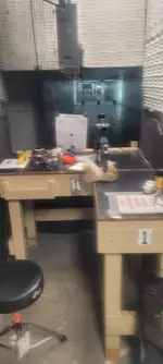

PICTURES!!!!!!!
25 YARDS, 50 YARDS, and 100 YARDS.
I tried slugs from 22 grain up to 40 grains. The zan 25.4 grain slugs shot well, as did the 30 and 34 grain Corbin slugs. Tried the 35.5 grain ACE slugs and they were good, though need to up the speed. Will install stronger spring and shot them again as they were maxing out around 905-910 fps. The zans got them up around 1040 fps!

So whats your initial impression?
Initial impressions are good, better than the tj for sure. I am able to shoot one slug, change for another slug....then go back to the original and the ammo groups what it did before. So much more consistent in that regards.
I can remove the shroud and install the tensioner and that should help, as well as the heavier spring.
Right now all things look good and I'm happy

Oh wow, that was fast.....sweet range!
Lol, seems the 25gr jsbs didn't do too hot?
We're the Hybrids ok beyond 25Y?
On more question😆...Do you know what spring is in your ghost currently?
Definitely looks promising with some of them groups👌
Didn't shoot any pellets...I could next time I suppose.
The hybrids I honestly didn't shoot pat 25 yards.....not sure why honestly, but I will do that next session.
Spring is the standard 22 caliber version
