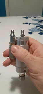

Reread all your HPA fitting articles, Thanks again! The issue with mine seems to be the 'throat' portion on the Air Venturi male one on the air filter is to small, In the picture the difference is evident. I will measure the outlet portion as you did in your article. What is odd is that Hill pump fittings clearly say Air Venturi on them....so what gives Air Venturi!?!? What I may do is spin the female out, put it on my pump so those 2 connect well and then use the original on the outlet of the filter to connect to my guns, PCPS ARE SO FRUSTRATING....but I love them so so much😂 😍😍
