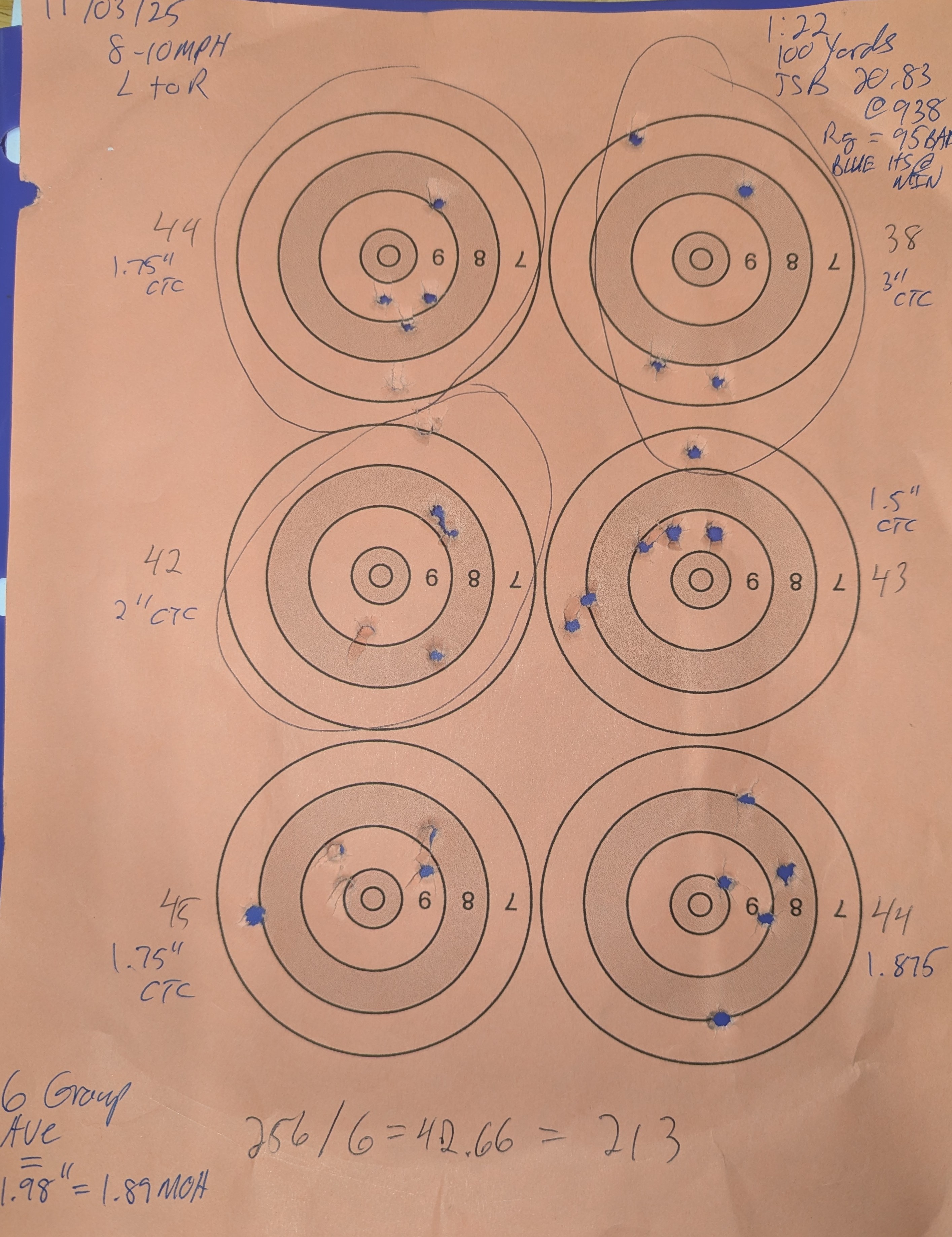

Blue hammer spring on MIN + reg @ 95 bar = 930-940 with JSB 20.83 Lights
Blue hammer spring + reg @ 95 bar = max of 830fps with Grands (regardless of the hammer spring tension wheel)
Blue hammer spring + reg @ 95 bar = max of 870 with MRDs (regardless of the hammer spring tension wheel)
ie, need a higher reg pressure than 95 bar for the 25.4 and 28.5 grain JSB .22 pellets
I had high hopes for the JSB Lights, based on how they shoot at 50 yards. But for whatever reason, accuracy falls apart at 100 yards with these pellets from this barrel. 100 yard EBR cards are in the 200-215 range with the Lights. And that includes some late night (no wind) cards. This one is on the better end of the spectrum for the Lights from the 1:22 barrel.
And this is with a fairly consistent tune, similar to what was shared earlier. JSB .22/20.83, with tune described above.
I've also tried the LIghts at various speeds, up to as fast as 1010. They didn't get any better at different speeds.

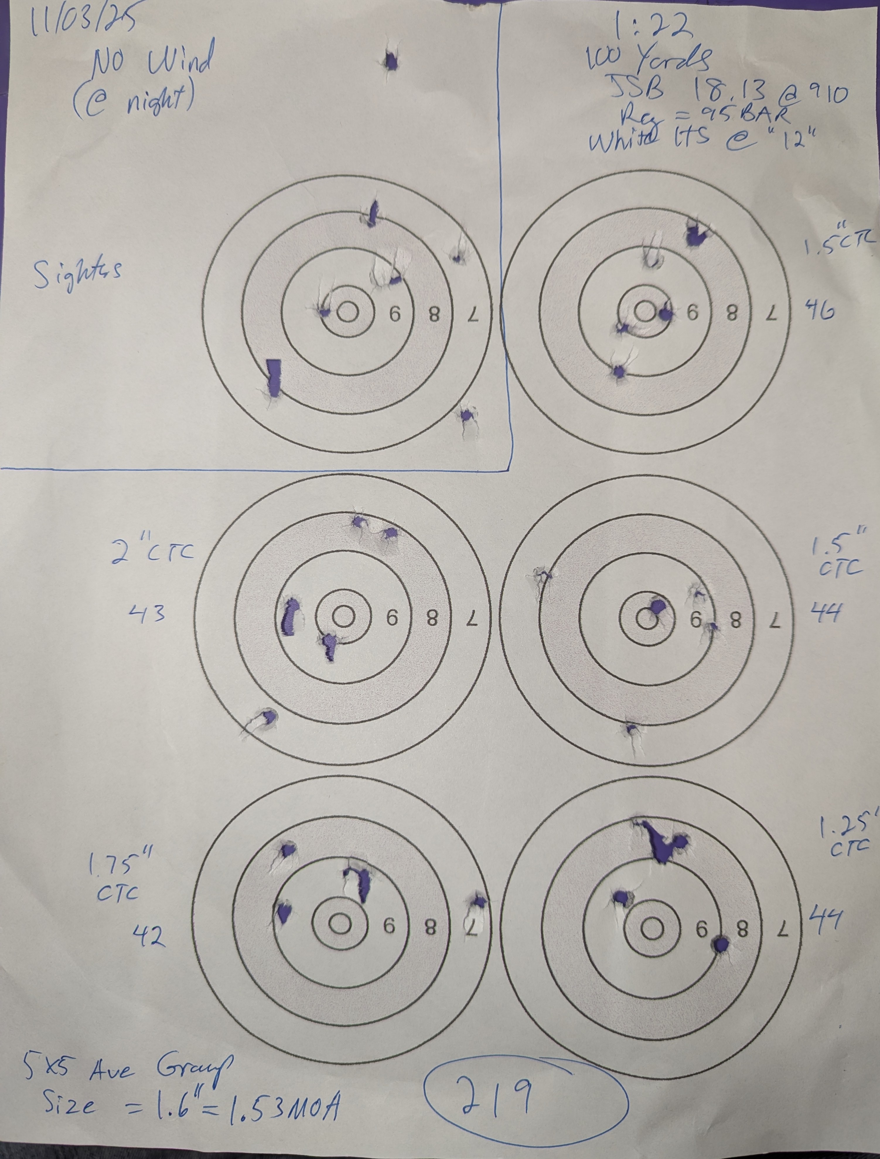

JSB .22/18.13
To me this pellet is the quintessential .22 pellet. Almost all .22 PCPs that I've tried have them, if the gun can be slowed down to produce 880-920fps with them. So, I shot a bunch of 18.1s from the Blackwolf, just to "see."
The 18.1s shot the best 100 yard EBR score from the BW yet, a 219. Which isn't great, but respectable for a pellet with such a low BC. These 5x5 groups @ 100 yard average out to just over 1.5moa, and that's 25 consecutive shots. And for those familiar with the EBR scoring format, only 1-2 shots were solidl 7s. There are a couple that likely plug up to an 8, but all the rest were 8s or better. The 8 ring is two inches in diameter.
Extreme spreads were a bit wide with the 18.1s also, 890-910fps in my notes. These midweight .22 pellets are where I think the Blackwolf could likely benefit from a spacer inside the plenum. I suspect we'd see tighter ES with that trick.
