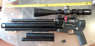

A "little" project with some help from Tom (thanks much!) in the way of the new captive hammer/spring assembly and a probe for my P-EVOL project... a 177 comp pistol for AAFTA based pistol ft and EFT.
I'm still waiting on a new guage block as my early 1st gen one won't fit this new tube, but it still falls within rules. It sports a 12" barrel and this custom shroud. IF I had a Mini, I would have made the barrel 10" like they currently are but getting 20 ft lb is easier with this. It's quite competitive 😀 and a JOY to shoot...
Also fitted a 15" , 177 so I could use the factory tensioned shroud arrangement...
Had to make a whole new valve and custom hammer spring to get this down to 12 or 20 ft lb... Tom's is designed for high power and flows too much to get that low. It shoots quite mildly and is as accurate as any I have with just about any pellet. It gets a LOT of shots per charge but I've not counted so don't have a number there. I love this rifle and really wanted to compete some with it and ft has been my main focus over the years. It makes 12 ft lb @1400 psi w my short hammer spring and lite hammer and 20 ft lb @ 1700 psi with slightly longer hammer spring and lite hammer.
I also had reached out to Darko of Custom Mags about a 177... I didn't really want to make one and figured it will be a bit before Tom offers one. Well, Darko came through very quickly... talk about cutomer service... AMAZING...
Mags in 177 plus a single shot tray and loader. Mags work perfect..
Still shopping for a nicer grip.
Thanks again... Tom and Darko...
Bob
