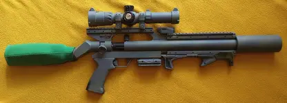

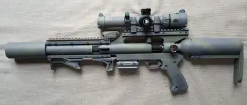

My TalonP project, as far as the build is concerned, is basically done at this point. I found a small light that works well and stays out of the way. I still might get around to an ammo holder and a different stock setup, but for now phase 1 is complete. I just need to start trying some slugs and see if they are worth doing out of this. Here is a pic of how I got it, and how I changed it. Definately my biggest make over yet.
before:
and after:
before:
and after:
