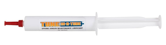

Spring/Piston Tune in a tube
I never used it .. some do and day it's good and some don't .
I'd go to like GTA forums and look at what's said on it there . Lota springer guys there with opinions ..
To start
I've used krytox , moly , copper neverseize/Beeman lazor lube .
If it's twanging or something . I'd think I'd just break the gun down clean inspect things and of nothing looks out or the ordinary reassemble with fresh lubes ..
Mater of fact I just took one apart a week ago to clean and freshen lube in it .. I get a lot of dirt and dust working upin the action around the stocks openings.
Not that I practice what I preach but maybe this stuff could do .
Choose a tar and a moly and have it for rebuilds/tunes, or refresh jobs
Thanks for reply, good info.
They claim that if you use tar you should just need to apply it to the center 5 or so coules ( maybe a inch +/- worth of center of mainspring) .
A little twang don't bother me much unless it's excessive if that I go back in and inspect stuff .. I'd assume you'd not want to apply too much and it causes things to bogg down . Sometimes twand is from a worn or loose/ poor fitting guide . The guide in this gun is getting long in the tooth and twangs a bit more then before ..lol
Like hw a guy use to go to pyramid and buy a new factory guide ($8) but now you can't .. hw has really feel off bad . Seems it's all pre-order or no longer available ... How the mighty have fallen ..lol
