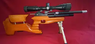

I have regulated bandit tube fraken Carbine I built up with all custom parts including 12 inch barrel. Its tuned to 485fps at .22 with 14.3 jsb's . Laser accurate to 50m . I get 4 mags (28shots) between 200-100 bar then it drops of reg a few shots later. It's now heirloom grade airgun for me. Love it:)
Cheers

Hiya you should polish the chamber and leade and deburr the transfer port , after that loading is smooth as butter.
