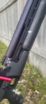

I did get the BellyDump here today, and of course it is already installed on the rifle. You will have to remove the small section of pic rail that is attached under the barrel. So remove the bottle and remove that small section, then install the rail and put your bottle back on. The ARCA section of the rail is just under the barrel, and above the bottom line of the bottle. So even with a bipod attached the rifle still sits in and low. The only thing with the standard stock is that the cheek piece is a little low and I would like something adjustable. So may have to look around and see what I can find.
But as of right now things seem solid and nice. Will know more when I get out and actually use the rail.

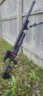

Here is a picture of the rifle with the Bellydump rail on it. Not thinking tripod use will work with a clamp, but a carriage on the bottle would work.
you can also see the bolt knob as well. Made it just a bit shorter to clear the thermal clamp.
The rifle looks far to bland....may need to add some color to her sometime this week!
