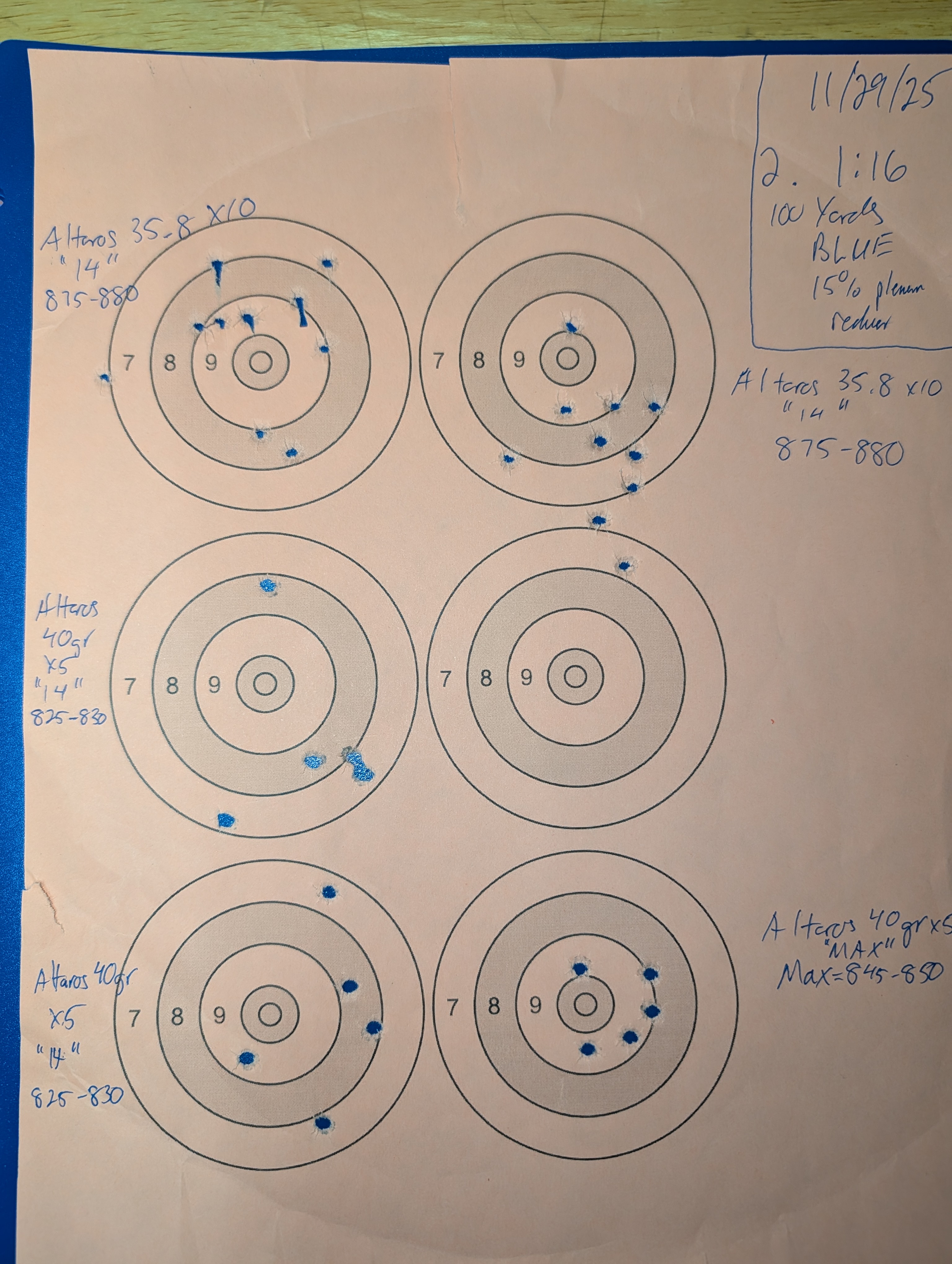

Bottom right here is 9 into a bit more than 1", with the tenth shot kind of ruining the group. 100 yards.

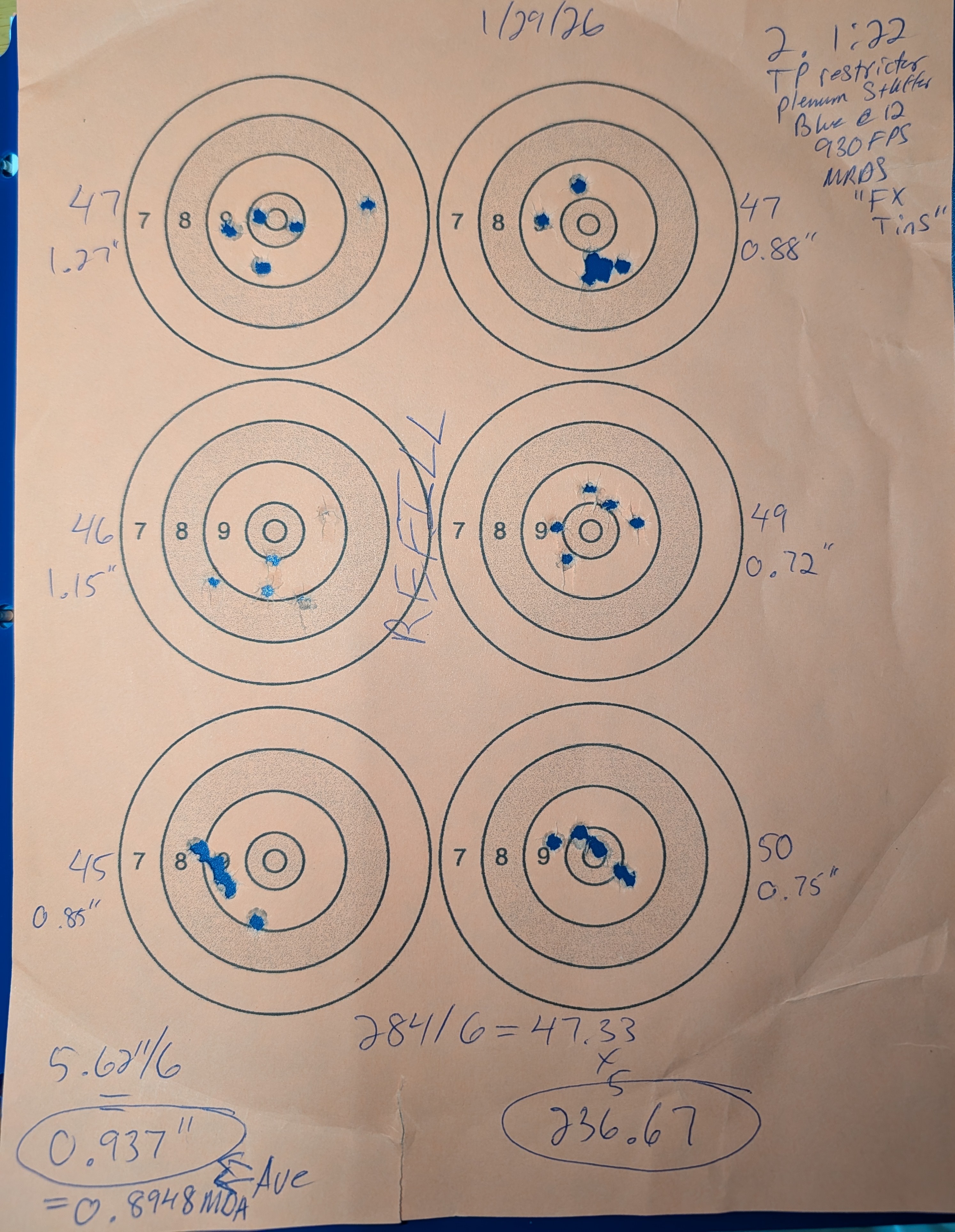

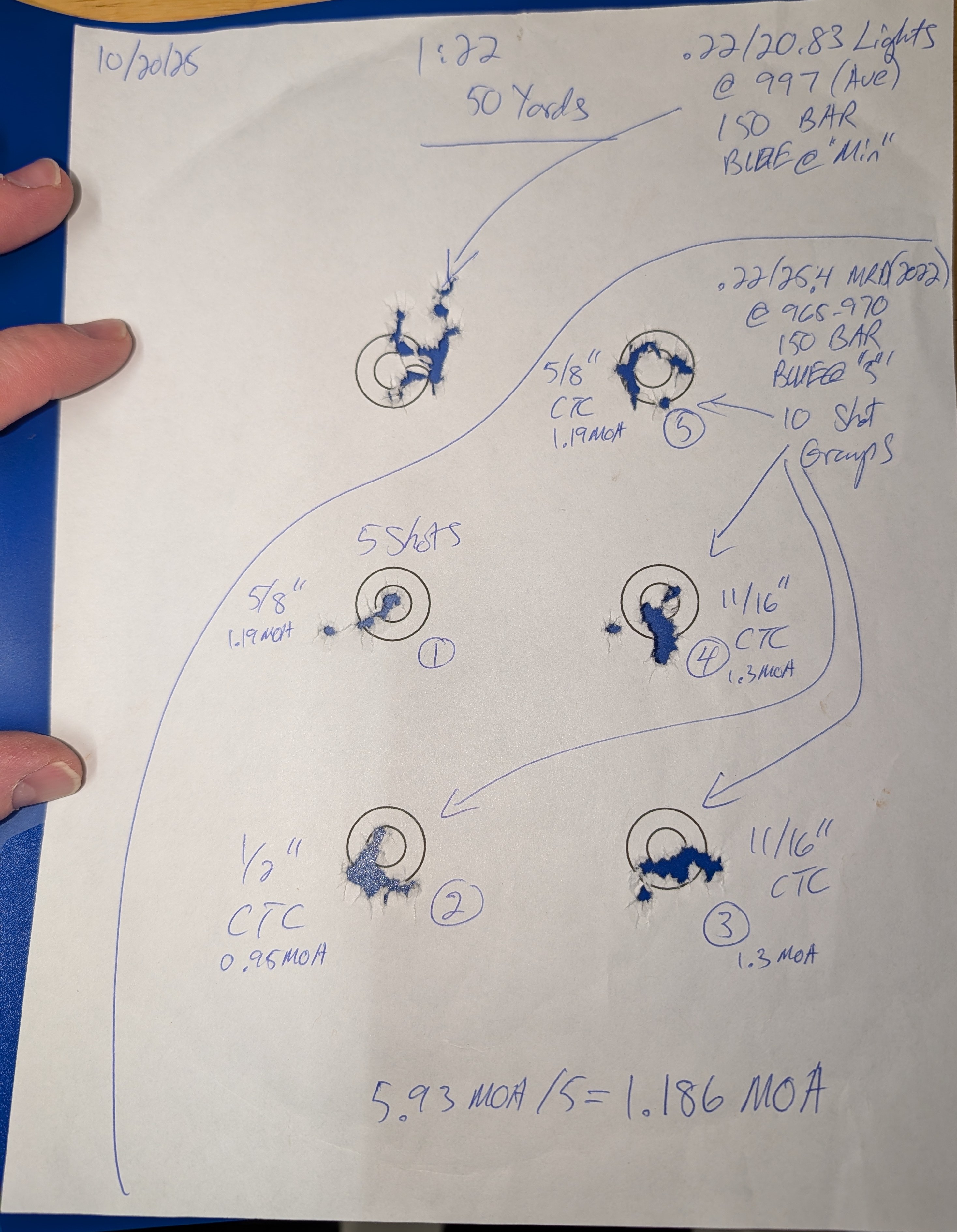

SubMOA 1:22 or 1.1:22
@ 50 yards
@ 19fpe
@ 100 yards
SubMOA 2.1:16
Slugs @ 100

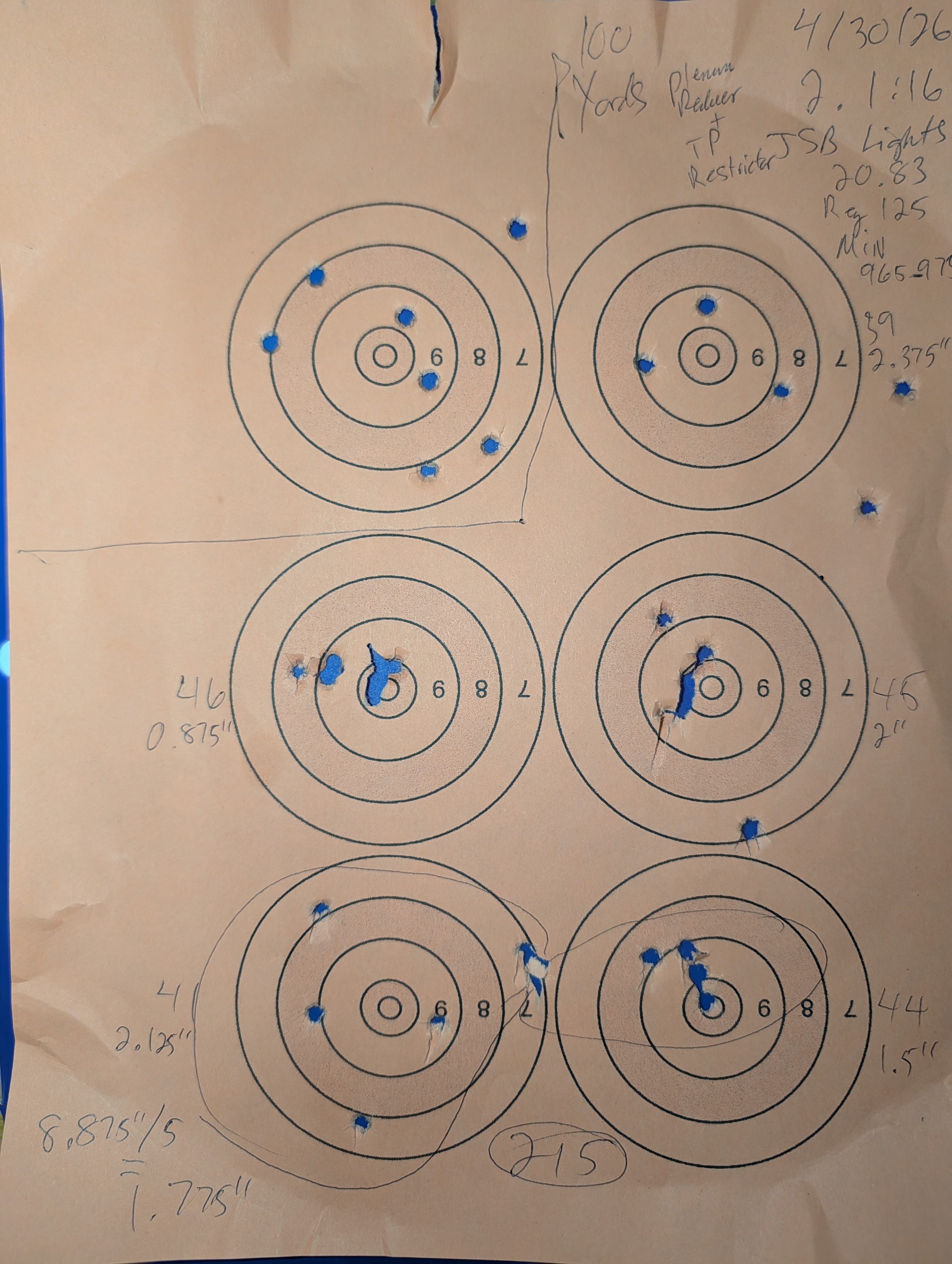

Tried some AEA 21.9s and some JSB 25.4s through the 1:16 barrel yesterday afternoon. Experimented with 870-950 with the 21.9s and went from 850-930fps with the MRDs.
WInds were gusts into the low 30s mph, so not ideal conditions. Not calling it conclusive by any means, I mostly just wanted to shoot.
The high point was a ten shot group @ 50 from the 21.9s that went into about a 1" group. But it wouldn't do it again. Generally I was looking at 2" groups @ 50 yards and 5+ inch groups @ 100 yards. Seemed to have some curve balls and what-the-hells that weren't agreeing with the wind direction and intensity. But definitely need to put some pellets through the 1:16 in better conditions before I pass final judgement on that combo.
@Franklink, I have shot the AEA 21.9 in the wind, and it does not take much wind to start moving them around. The AEA 25.3 definitely performs much better in the wind, and it should do better since they weigh more. Great reviews on the Black Wolf, too!!
Pellets from the .22/1:16 SubMOA

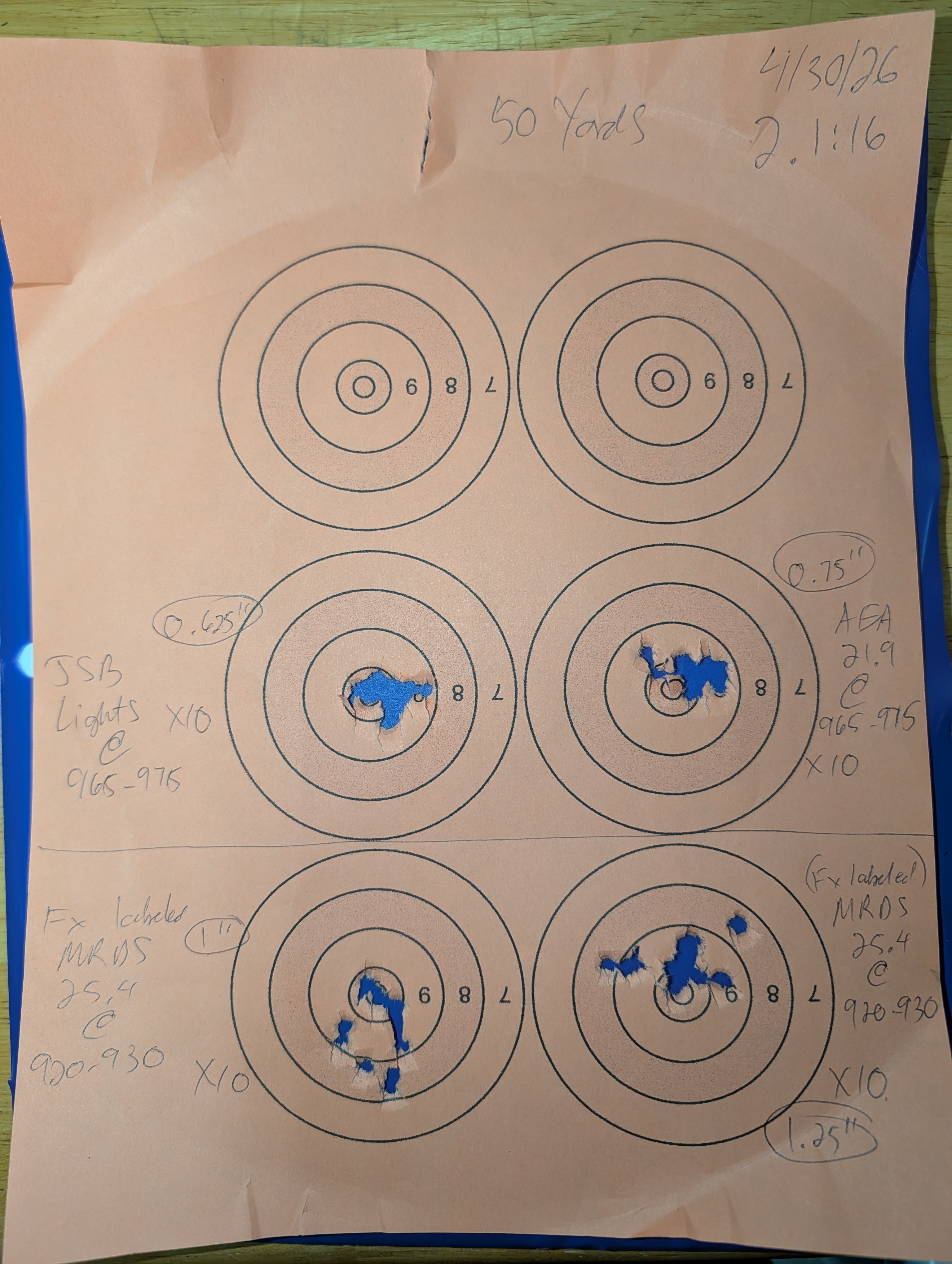

Winds @ 8-14mph for all of the below...And I was watching wind ribbons and holding off to account for the wind, best I could.
50 yards first...
Middle left is JSB Lights - ten shot group measures 0.625"
Middle right is AEA 21.9 - ten shot group measures 0.75"
Bottom left and bottom right is JSB 25.4 MRDs - one ten shot group measures 1" and the other ten shot group measures 1.25"
The JSB Lights and the AEA 21.9s were respectable @ 50 yards. The MRDs didn't want to behave. I tried the MRDs faster and slower than the 920-930 noted on the target, but this was about as good as they'd do. I didn't stretch the MRDs to 100 yards because of how they weren't flying straight at 50.

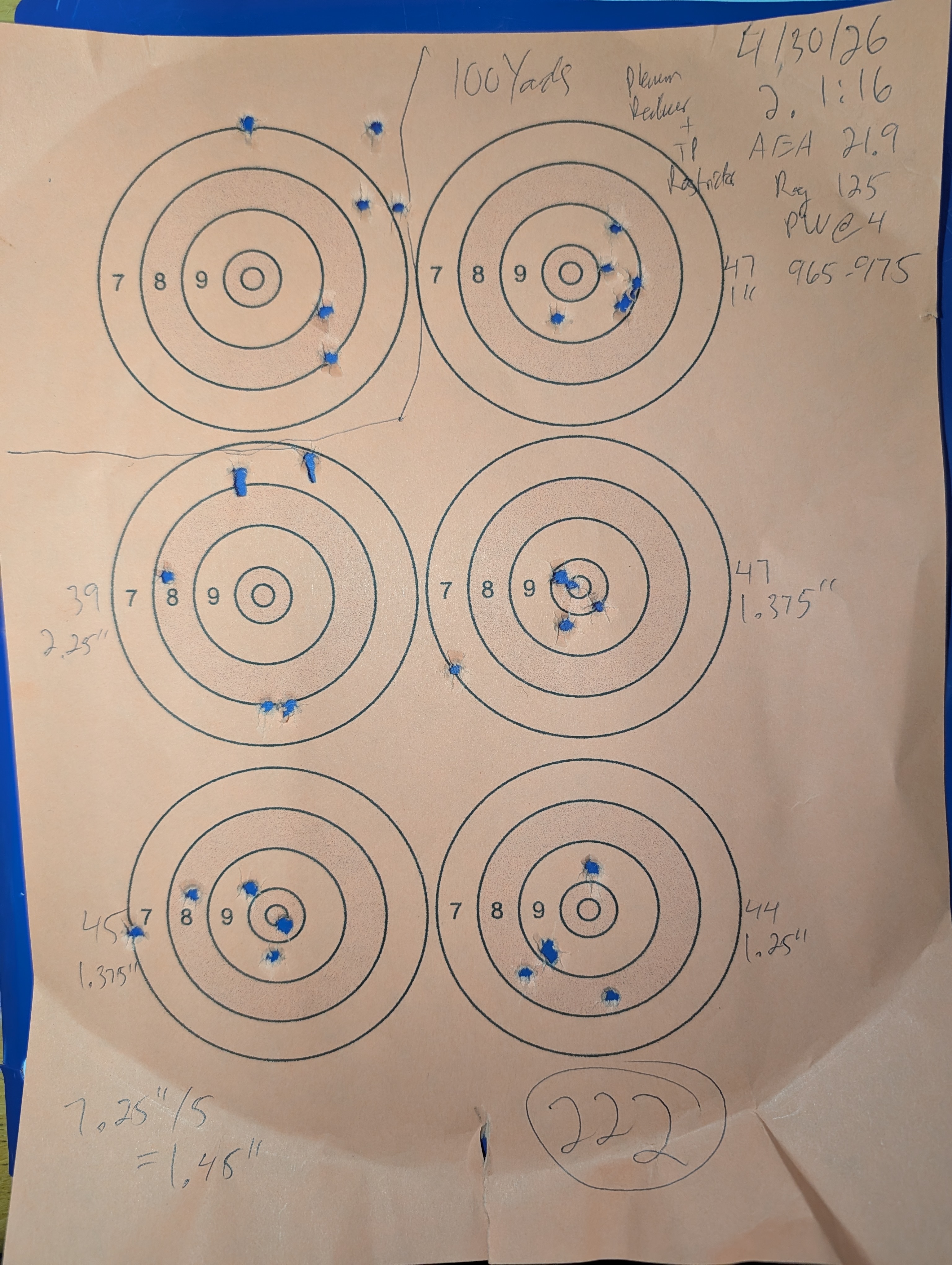

Now, Lights @ 100 yards
And AEA 21.9 @ 100 yards
I tried all three of the above pellets at faster and slower speeds, and these speeds seemed the most accurate/least flyers.

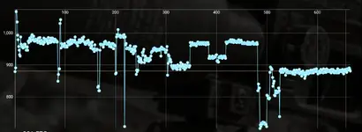

Bit of a fun image here...
This is the last 665 shots I've taken from the BW. Can see where I adjusted to a certain point and then shot a bit at that same speed. The most recent (far right) represents about 120-140 shots with 18.1s @ 880, most of which was just now, plinking at a 3" pickle jar lid I hung on the fence @ 150 yards. Pretty dang fun. With a 50 yard zero, needed to dial in 5 mil, and then hold over another 4.5-5 mils, depending on the wind shifts. But I could hit it and/or get dang close with most of the shots, even in shifty winds.
