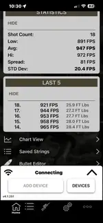

Well, this morning I shot the Airforce EscapeSS .20 for the first time to get an idea of what it could do, and I was impressed but I am sure the wind could mess things up in a hurry past 30 yards. It was almost completely turned down all the way, but I left it in the mid 900s to help with the drop at 50 which was about 1.5 inches. It can do 18 good shots from 29-25fpe 972-891fps, with 13gr pellet 2600-1600psi probably more but I didn't try. The JSB 13.9gr was the only pellets I had but I thought they did very well. I was using a 12x scope might have done a little better with 16x but I don't know. The NSA slugs were too small of a diameter, and I will knurl some to see if they do better. The 13gr slugs were awful but the 18gr slugs might work after knurling and some tuning.
