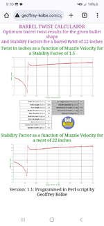

It may not stabilize pellets at any fast or slow speed. It is (likely) a slug oriented barrel that is a 26:1 twist rate, and therefore short pellets and short slugs probably won't spin stabilize. Other's with the 30 are having good results with slugs along the lines of what specs I put on this twist rate calculator to generate this screen shot below. There's a few posts on this HAM Western sub-forum that tell of the two barrel types look like and good slug's and speeds they use.

Fine job sir! You may be correct in the 22:1 ratio. I measured my 45 Long Strike several times and it measured a few inches below advertised also. All that means is that we need to use a projectile that fits closely within those perimeters and fine tunevthe diameter and length from there.

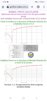

Here's screenshot of couple of theoretical slug types that fall right within the stability factor of 1.5 with twist rate of 22. Looking at the specs, one is a standard straight shanked slug and the other is a rebated boat tail. Griffin Slugs has a few weights and lengths in these that you should try.
Also, the bore diameter matters, as does slug diameter. Because a lot of .30 caliber air rifles start with an pretty exacting bore diameter of .300" then I'd buy some slugs that are a little over the bore diameter.
ASV makes over bore sized slugs. Another member said that his .30 Sidewinder High Energy version likes ASV .3013" diameter ammo at 61.5 grains, but his twist rate was slower at 26:1 too. I'd give them a shot, and some of the longer slug's too.
