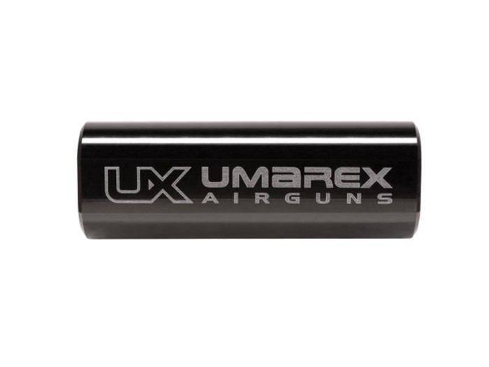

Now Air Venturi has introduced a screw-in HPA tube conversion for the Komplete. This can be filled from a tank, hand pump or compressor. That makes it a “real PCP” according to conventional thinking.
The Umarex Komplete Is The Most Versatile Air Rifle Ever!
The Air Venturi PCP Conversion Kit simply replaces any of the other power sources for the Komplete. Indeed, it’s possible to shoot the gun using large or small CO2 cartridges, Nitro cartridges or HPA with no alterations to the gun at all. Just de-gas between filling as you would expect…
The HPA Conversion Kit tube is not fitted with a pressure gauge. However this is not really an issue as most people will fill using the larger – and more accurate – gauge on their tank, hand pump or compressor.
Air Venturi’s HPA Conversion Kit provides an HPA tube capable of being filled to a maximum of 3,625 PSI. The 130 cc capacity gives 35 – 40 shots per fill before the regulator set point is reached.It’s in stock now.
The price is $99.99. That’s in addition to the base gun price of $199.99.
