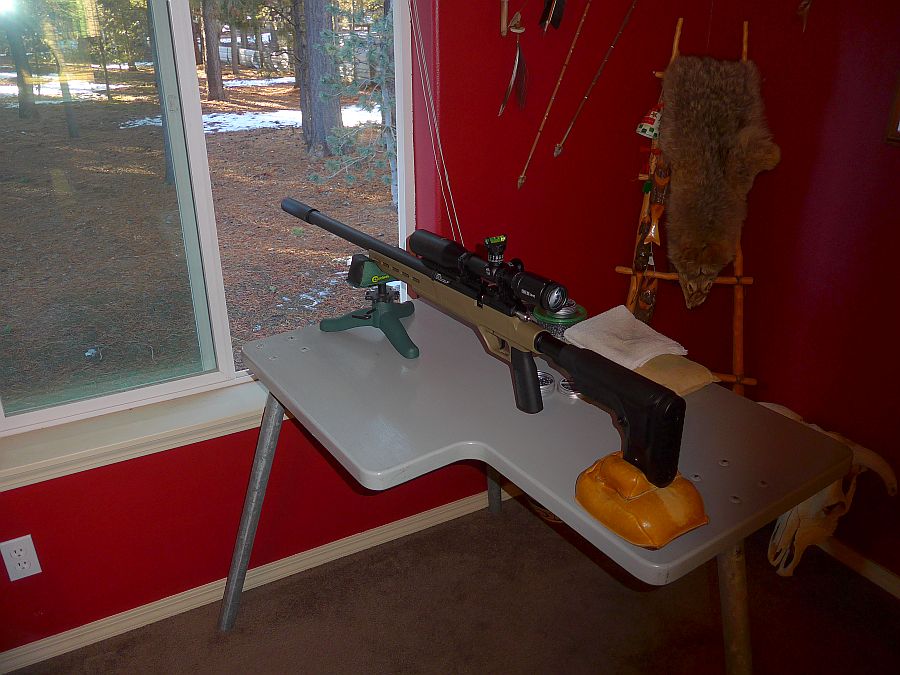

Love the way you can setup your bench inside during the cold season too man. Stay nice and warm and slay the critters or the bullseye's anytime! Night vision for it next? Oh yea.

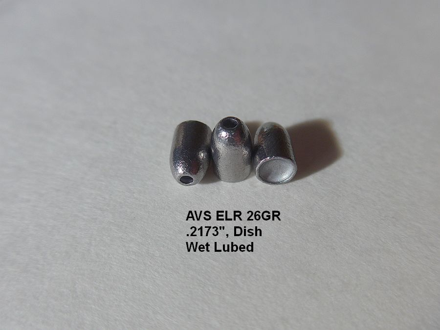

Today was first attempt at shooting slugs from the 250z in .22.
For my first slugs I chose AVS ELR slugs in 26gr, Dish, .2173". I wish I could report that the rifle just loved them and was stacking them but that wasn't the case. In fact, the rifle doesn't like that particular slug much at all.
I shot them at velocities from 890fps to 950fps. I stayed mostly at about 940fps. I was getting good low ES out of the regulator but the bore just doesn't like that particular slug.
I also tried the same slug but in 30gr. I quickly learned that slug is too heavy for what the 250z can deliver.
What I learned today was the weight range of slugs that are correct for the stock 250z. Considering the rifle's resources, I feel like slugs from about 21gr - 25gr is where I need to be.

No further luck with the AVS ELR 26gr .2173" slugs. I won't shoot those again from this rifle.
Have some H&N 21gr .218" slugs ordered for next slug testing. At the very least..., if I can't find a slug tune that shoots with enough shot-to-shot precision I can always fall back to the 22gr pellets at a good high velocity.
