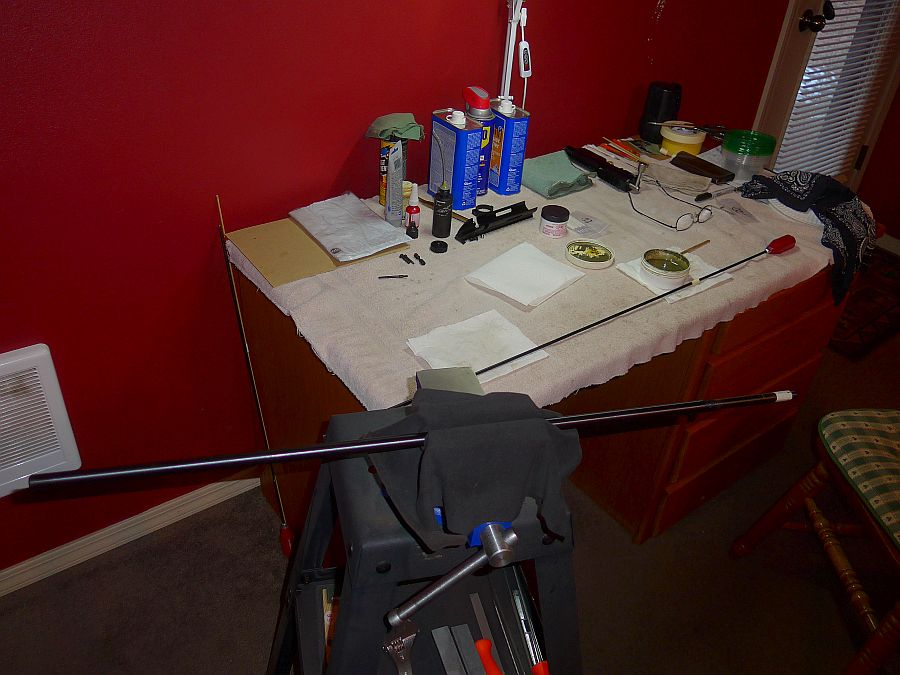

Wanted to give a through explanation of the steps I take for most of my reviews and figured I would start of from the beginning. What you will find below is my take on barrel prep, including a polish and clean.
Leave your tips, suggestions and feedback in the comments; as I know many will be looking to get everything sorted before this year's competitions.

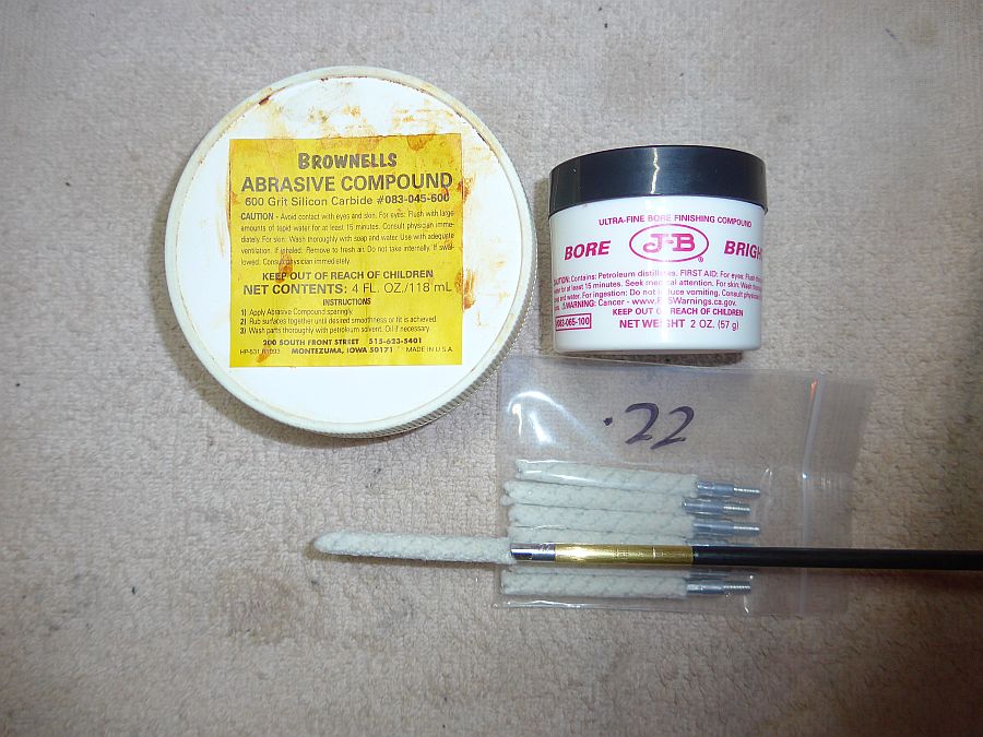

He did have 2 things backward. If he did 40 on breach end then 40 on breach and middle then 40 whole barrel thats 120 on breach and 40 on crown. Jb bore paste is a cleaner. Jb bore bright is the polish.
I think I miss spoke. 120 breech, 80 middle and 40 on the muzzle end. Wish I had caught that sooner. I’ll pin a comment on the video.
As for Bore Past vs Bore Bright this is the research.
J-B Bore Paste (Non-Embedding Compound) is a coarser, aggressive cleaner designed to remove copper and carbon fouling, while Bore Bright is a much finer, micro-fine paste meant for polishing the bore to a mirror finish.
Correct a chemical cleaner not abrasive cleaner. From the package—cheaning with jb every couple of hundred rounds will usually keep fouling to a minimum.
Interesting that it recommends a separate solvent. Wouldn’t that be the chemical cleaner? I don’t see anything on there that suggests there isn’t an abrasive in the paste?
Further research….
“J-B Non-Embedding Bore Cleaning Compound is an ultra-fine polishing paste, often described as finer than jeweler’s rouge or roughly equivalent to a 1000-grit or finer abrasive, designed to remove fouling without damaging rifle barrels.“
In regards to JB bore bright….
“While exact micron/grit numbers are proprietary, it is often described as extremely fine, sometimes compared to ultra-fine lapping compounds, often cited by users as finer than 1000 grit.“
Well as i was told the non embedding meant it did not etch or soak into the metal there may be some very fine abrasive but would you think they would use it just ahead of the chamber every couple hundred rounds if it was really abrasive at all? And why would they call it bore bright if it didn’t polish?
