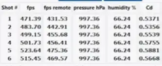

The only thing I could find (I could be wrong - again, produce the formula to prove me wrong) that provides a "air resistance efficiency number" type of thing is the Coefficient of Drag - Cd
That can be calculated directly from the 2 speeds & air density, HOWEVER is only a number for the specific velocity.

The trick is a BC isnt a single number, its a drag curve, a collection of numbers: drag coefficients of at different speeds.
Using a Cd in ballistic calcs....
Depends on what you want to do...
If you want to find the "most efficient projectile" for you - a single Cd value at the initial speed you'll use your pellet at will give you that answer.
If you want to calculate drop of projectiles:
At a specified/single distance: a Cd value at that initial speed & distance will work.
If you want to calculate drop of projectiles at different distances:
You need a drag curve - as the projectile will potentially be moving through all the different velocities as it goes down range.
