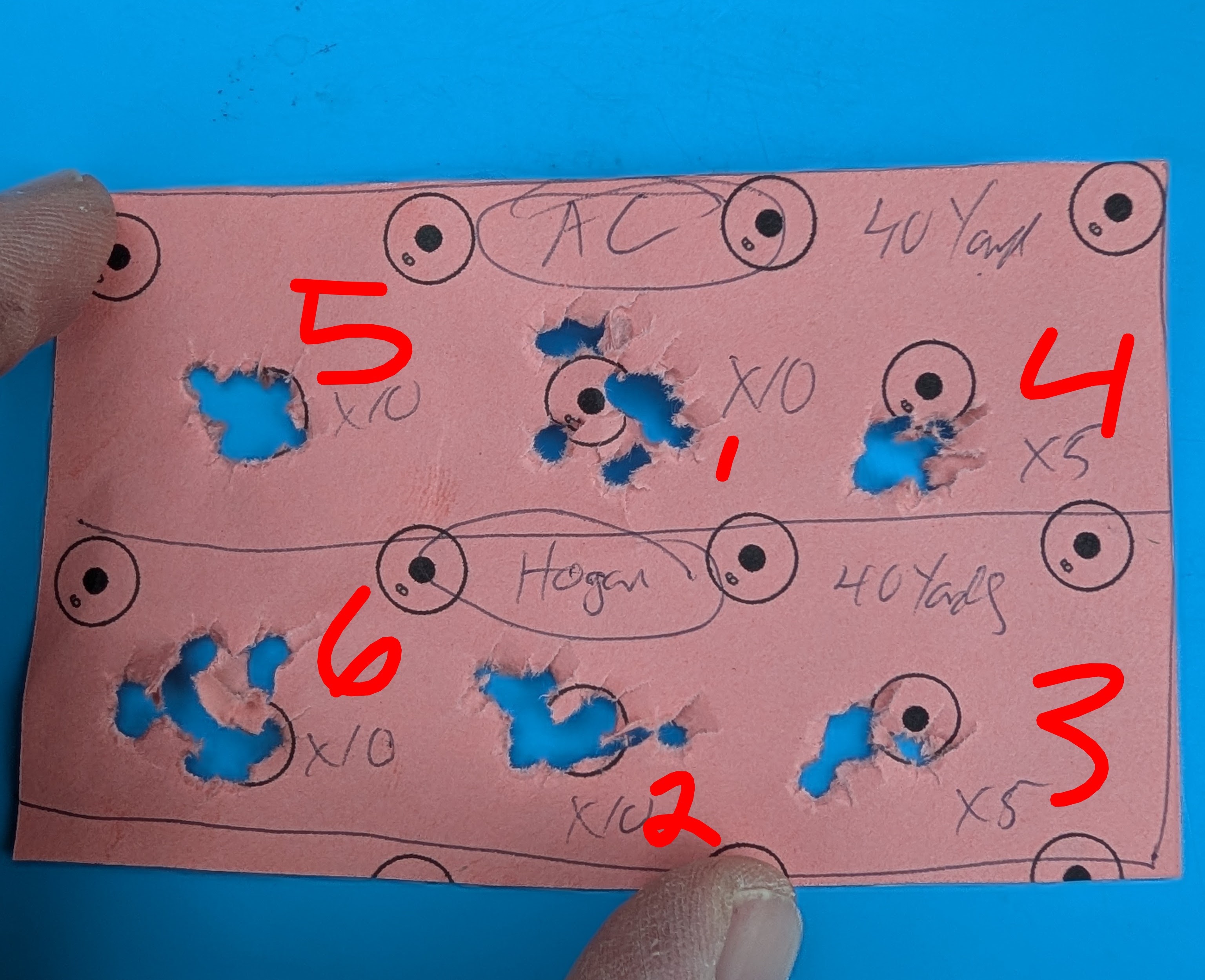

After the pistol ft match on Friday afternoon, and after cooking myself some late lunch/early dinner, I had a few hours to practice and test out the Hawk. First thing was to decide how it compared to the Hogan, in terms of report. And that checks out. The Hawk is the quietest 3-5" moderator that I've tried. Almost as quiet as the Hogan. Quiet enough that the biggest sound I hear is the hammer hitting the valve stem, which is how I like it. So, quiet? Check. Next, does it mess up the accuracy of the gun? In the first few shots I realized that it was causing my POI to be about 0.2mils (2 clicks) lower than with the Hogan. So I added in the two clicks and then shot this comparison. This is 40 yards from a stool and sticks. Groups were shot in the order of the red numbers I added. The three groups above the line were with the Hawk, and the three groups below were with the Hogan. On the top right group I forgot to dial back in those two clicks of elevation, so that upper right group is slightly low. This is trying to hold for wind. I don't remember exactly but the circle around the dot is something like 3/8"

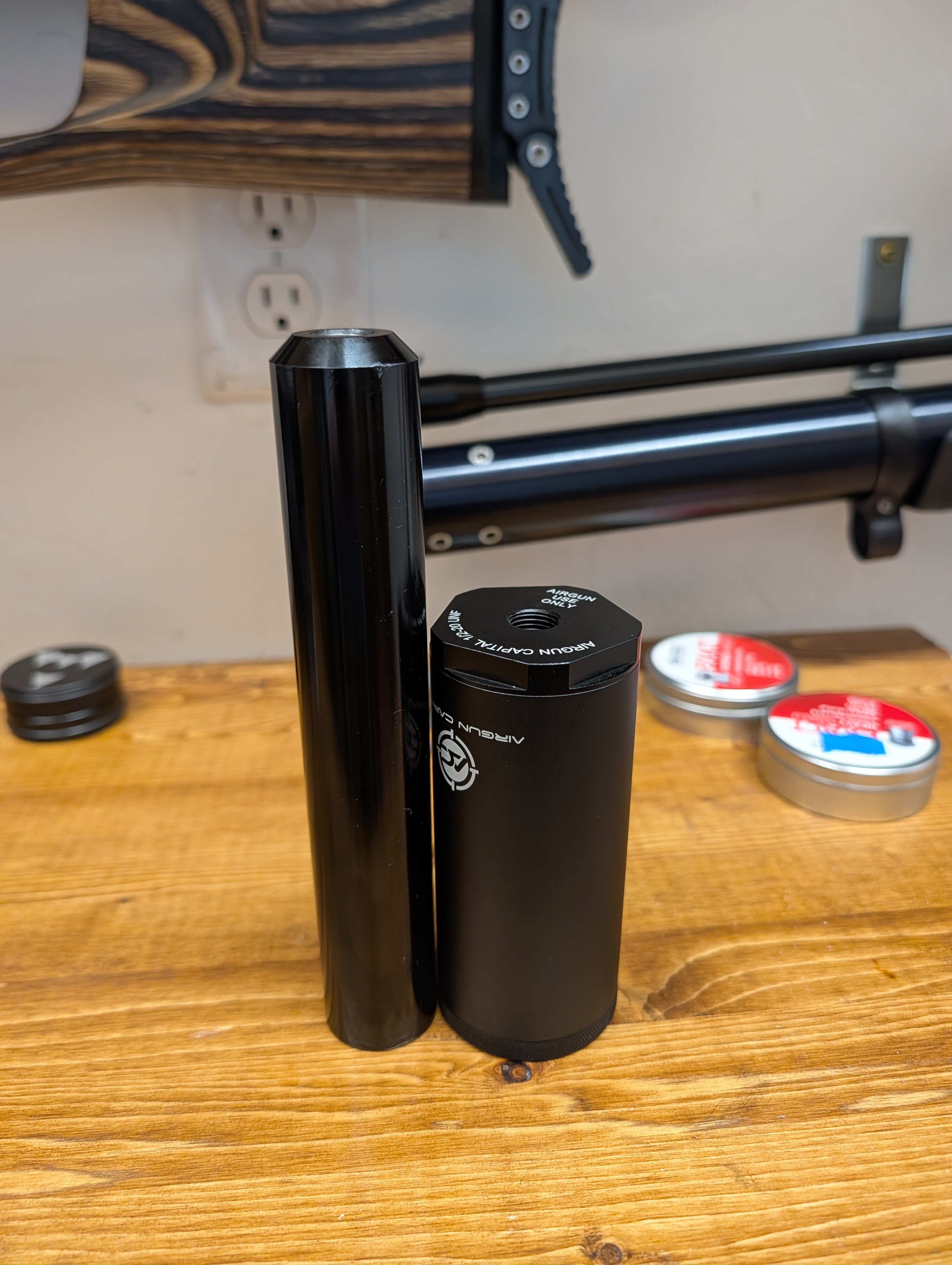

Size comparison to the 7" Hogan Decimeter...

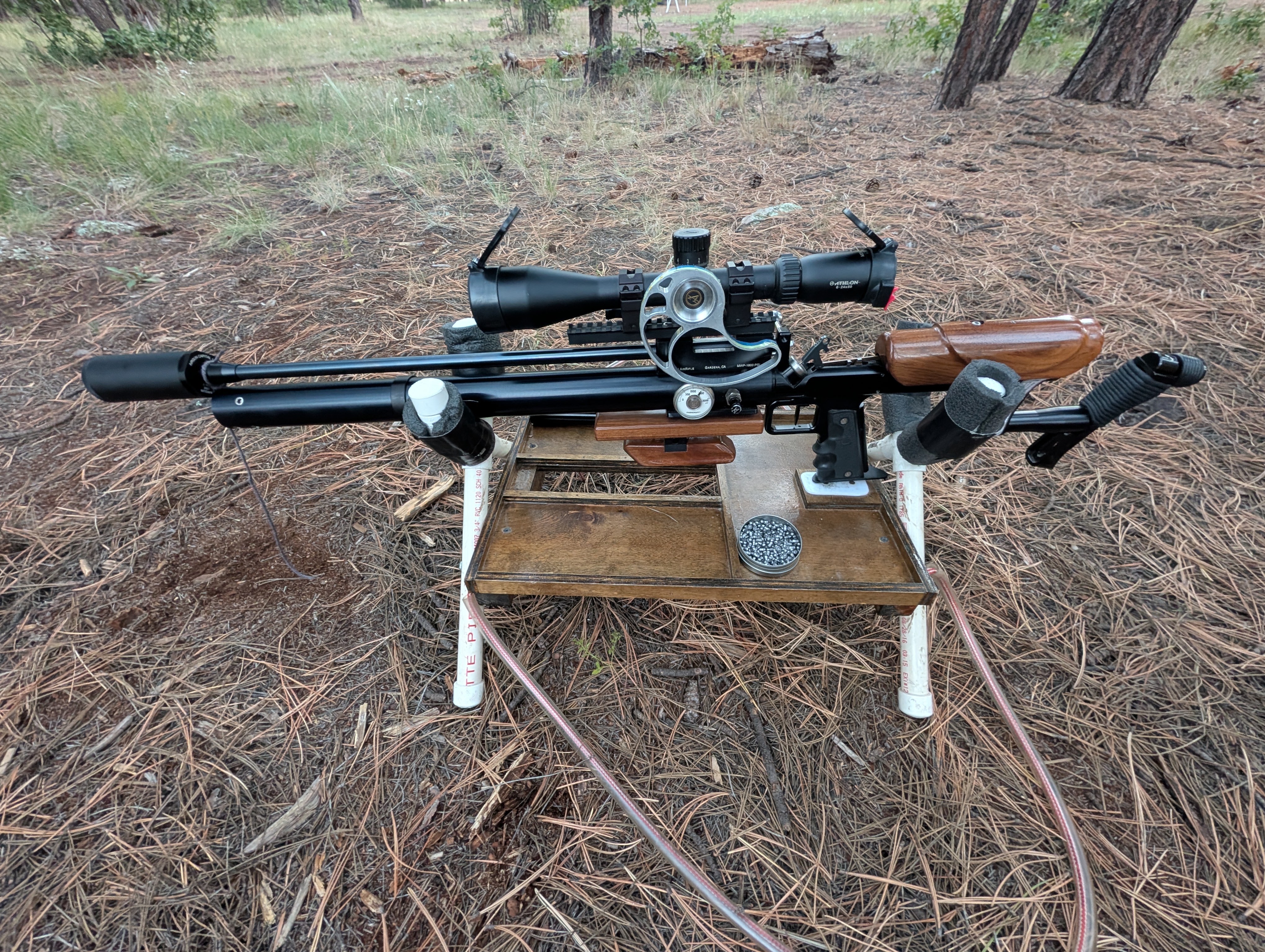

On the gun...aesthetics are subjective, but to my eye, it looks right at home next to that fat airtube...
