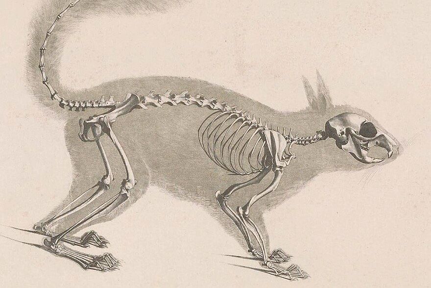

I’ve often wondered, are ground squirrels much different physically (from a shooting perspective) than typical tree squirrels? We don’t have any of the ground variety here, but we have plenty of other critters (the ‘dillos are coming, the ‘dillos are coming!).
I did a Google search for, "physiological difference between vital organs of ground squirrels and tree squirrels". There is a lot of difference with what some organs do with regard to hibernation, or not. However, I didn't find anything that would suggest vital organs between the two species are any different where pellet placement might be concerned.
Common sense (to me anyway) would suggest that overall body size of various squirrels would have a greater influence on where an airgun hunter might choose for shot placement. I emphasize, 'airgun' because unlike any common firearm cartridge, some airguns may not produce enough projectile energy to shoot through shoulder bones on large squirrels.
