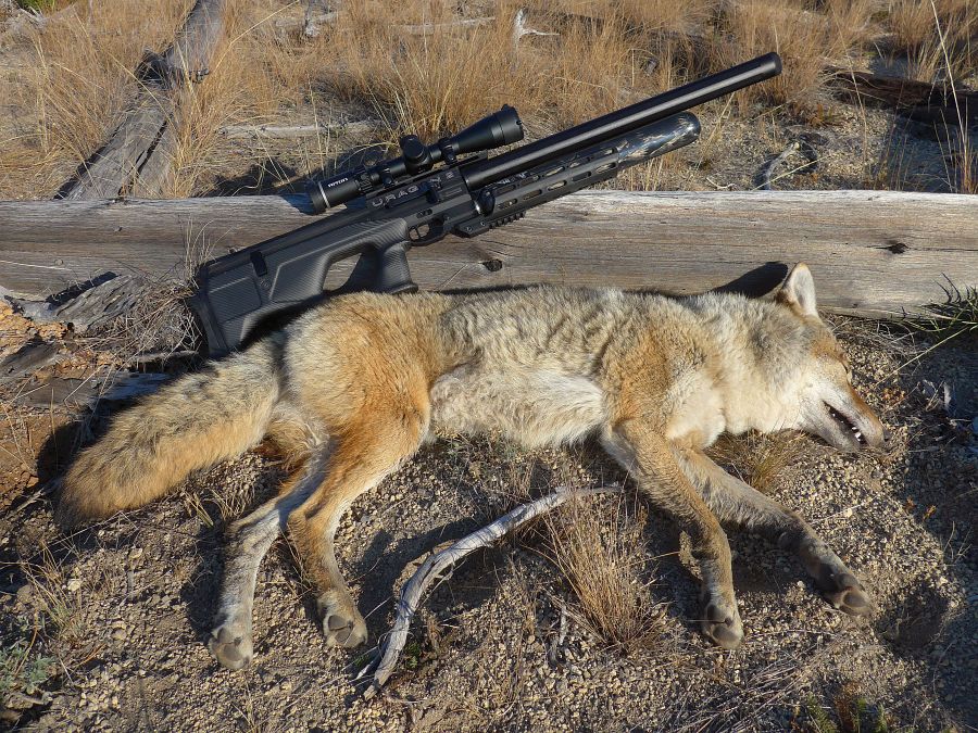

Uragan 2 (now, Uragan 3) is a good choice for a coyote calling rifle. It's a bullpup but it's very low profile. The rifle shoulders and feels more like a conventional rifle than a bullpup design. Overall length is shorter so it handles easily in the field. With a 700mm barrel it makes good power. Great trigger, excellent build quality.
.25 caliber, 44gr slug at 935fps to the back of the brain. Dropped in it's tracks and never even twitched!
Comes down to proper shot placement and FPE. Great job man! Love that gun brother.
Great pic and nice kill man!
