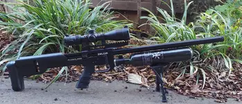

I pulled the .22 slug barrel out of my EscapeUL and put in the original .25 18-inch Ultra-Light barrel. This is in many ways the perfect small game gun. As it sits in the picture ready to hunt with 2x12 scope and buckrail it is only 5.84 pounds it shows a little more because of me trying to hold it and my phone and take the picture. It can also be purchased with an 18-inch .22 barrel. I was trying out all the different hunting pellets, and it liked the Hades and the H&H Barracuda Hunter Extremes. I was just checking initial groups and adjusting the scope no time to do a real tune. I was shooting around 870fps at 45fpe. I was doing some tweaking as I changed ammo but will eventually end up around 880fps. The groups are not perfect because I was also trying to adjust the scope. The nice thing is that both of these pellets shoot the same as far as the scope is concerned. It will shoot much better when I stop adjusting the scope and settle on a tune. That 800 -1200fps is probably the .22 I think the .25 gets about 600 - 1000fps.
