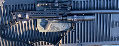

Here's a link to the new after market Western buttstocks for the Rattler. If you look at how it can be adjusted and mounted with a left or right slant (2nd photo in the link below), this is how mine moves freely since I lost that screw.
At least anyone interested can be directed to a product they can actually purchase. While it was fully assembled, it was a decent stock. Hard pads, but at least it makes the rifle slingable and much easier to sling-carry afield.
