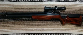

My first impression on shouldering my first Marauder was the same as yours with this one, it was heavy. Here's another Marauder, that, has noted, had many parts changed for task, many years later, and the heavy steel tube remains. [smh] It otherwise seems like a fun and reliable semi that just needs to go on a diet. Maybe JSAR could make an aluminum tube for this one too.
Titanium, shorter, and put that stock on a diet.
i paln to get one but i will be butchering and remaking some things from the ground up if my plans work out.
