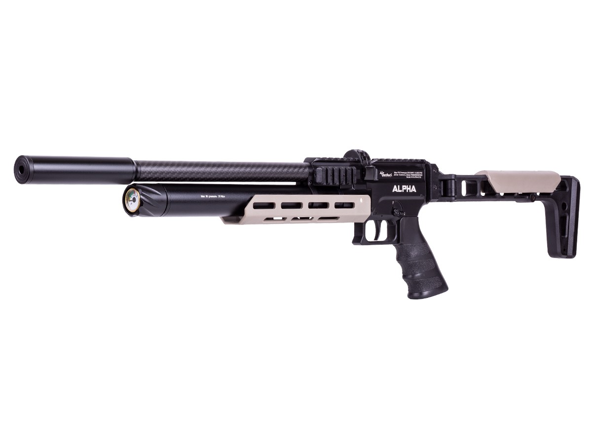

An Air Venturi Alpha has arrived in the HAM offices too - while I was out of town. I'll be getting to it in the next few days.
Personally, I like small, compact, relatively low powered PCPs like this. Other examples are the Notos and the Air Venturi Microstrike. My feeling is that they offer a lot of value for a relatively low price and could appeal to a lot of shooters.

So, how's the Alpha? And, how is the attached suppressor? Is it like a Beeman Chief 2 version? Attached, and still loud as a nail gun?
The glued on moderator is about my only complaint with it. Been working on a video using it, guessing it could be removed with heat.

Hard to complain for $269 gun that checks most of the boxes.

May be a bit more but Wes at Airgunarcheryfun has them directly from snowpeak and I believe will work with what you want. Looking forward to a Max 1 25 cal soon. I'm paying the tariff 🙄 but I like small business.
For those concerned about the moderator it appears that at least one is removable based on a comment in the review section of PA
TSathrum Dec 12, 2025
Christopher- The silencer is threaded and will unscrew. Mine was very tight and I had to put pliers to it, but there wasn't any glue or Loctite on the threads. If you put tools to it to loosen it, protect the carbon fiber shroud and only grab the black aluminum with your pliers. You might put several wraps of masking tape around the parts that the pliers teeth will grab to protect it. I put a DonnyFl Ronin on it and it is doing a fine job.
For those that don't want to mess around with the moderator, I offer a slip on moderator that really brings down the sound. I also added a picatinny rail on mine as I like to shoot off of a bipod. I offer different accessories for the Air Venturi Alpha. If you want to upgrade your Alpha check out www.bravo3d.com
I removed mine in a few moments with no damage. I actually put it back on, as it actually works good enough for me. Mine was held on with plenty of red thread locker.

I also removed mine, and yes, they have a lot of red Loctite on there. I bought an extension 1/2x20 and put a different moderator on, and I can open it to access the fill port with no issues!
