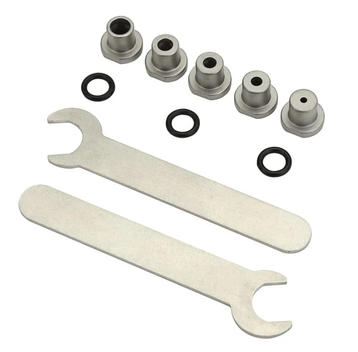

I've only seen a partial valve dump once....it was when I used the biggest transfer port in the Ring -loc kit and a full length .20 barrel. So that was probably not enough resistance to get the valve shut quickly. Apparently the opposite holds true too....too much construction (.177 barrel with a larger caliber valve) can create a valve dump....

I have a DIY idea for an adjustable opening top-hat like Talon Tune's. Take your .232 top hat to Home Depot to figure out the threading. Purchase a grub screw and drill it out to your desired port size. Blue loctite on the threads. Just need to make sure the grub screw is short enough to not interfere with setting top hat depth.

I've been quite pleased with this....
But your idea sounds like it'd work, for less $.

Exactly. A ring-loc alternative that isn't $50 plus shipping!!

Hey @Franklink I found this on my deep deep Condor rabbit hole researching and thought id copy/paste it here:
A Condor comes from the factory with a 0.232-inch orifice installed (except for .177 which goes out with a 0.166-inch orifice). The Ring-Loc Kit opens up opportunities in these areas. The 0.232-inch orifice is best for .22 and .25 calibers. It is not recommended for .177 caliber. A stronger valve return spring is also installed in the valves for .177 rifles.
The 0.166 and 0.145-inch orifices found in the kit works well for all four calibers. As you will see they give more range of adjustment and higher numbers of shots with proportionately less power. The 0.123-inch orifice is best for .177 and .20 calibers, though the larger calibers will work with it.
Im currently running the 0.145 and .22/18.1s at an average of 910-915fps.
