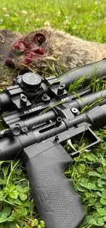

Got the mother and one of her offspring today while just out target shooting. The Stoeger XM1 Ranger 25 caliber did it's part and I did mine. One headshot at 20 yards for each animal and it was instant lights out on each one. I'll be busy for a week or two clearing out the rest!
I did my part yesterday also, as well as the AEA Element R .25 and the mighty Hades. About a 15 yard off hand dome shot. I used my motorcycle for concealment. This was I think last years pup. I took out Momma last year with my M3 Impact .25 and a 33.95 pellet at about 40 yards to the brain as well.
Great work getting rid of these destructive animals! Would like an FX to add to my collection as well. I'm working up to it.
