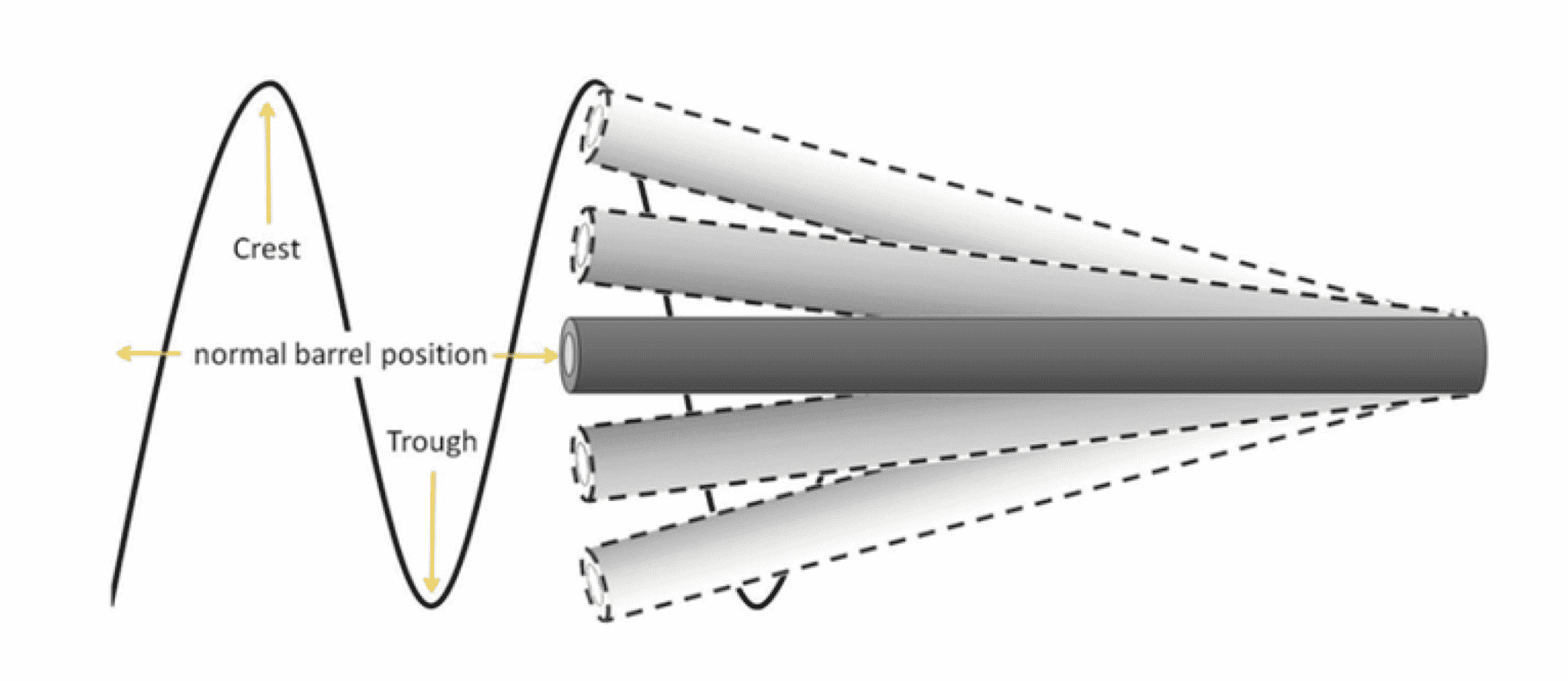

A write up on barrel harmonics if anyone is confused or interested. I’m still learning about this myself.
