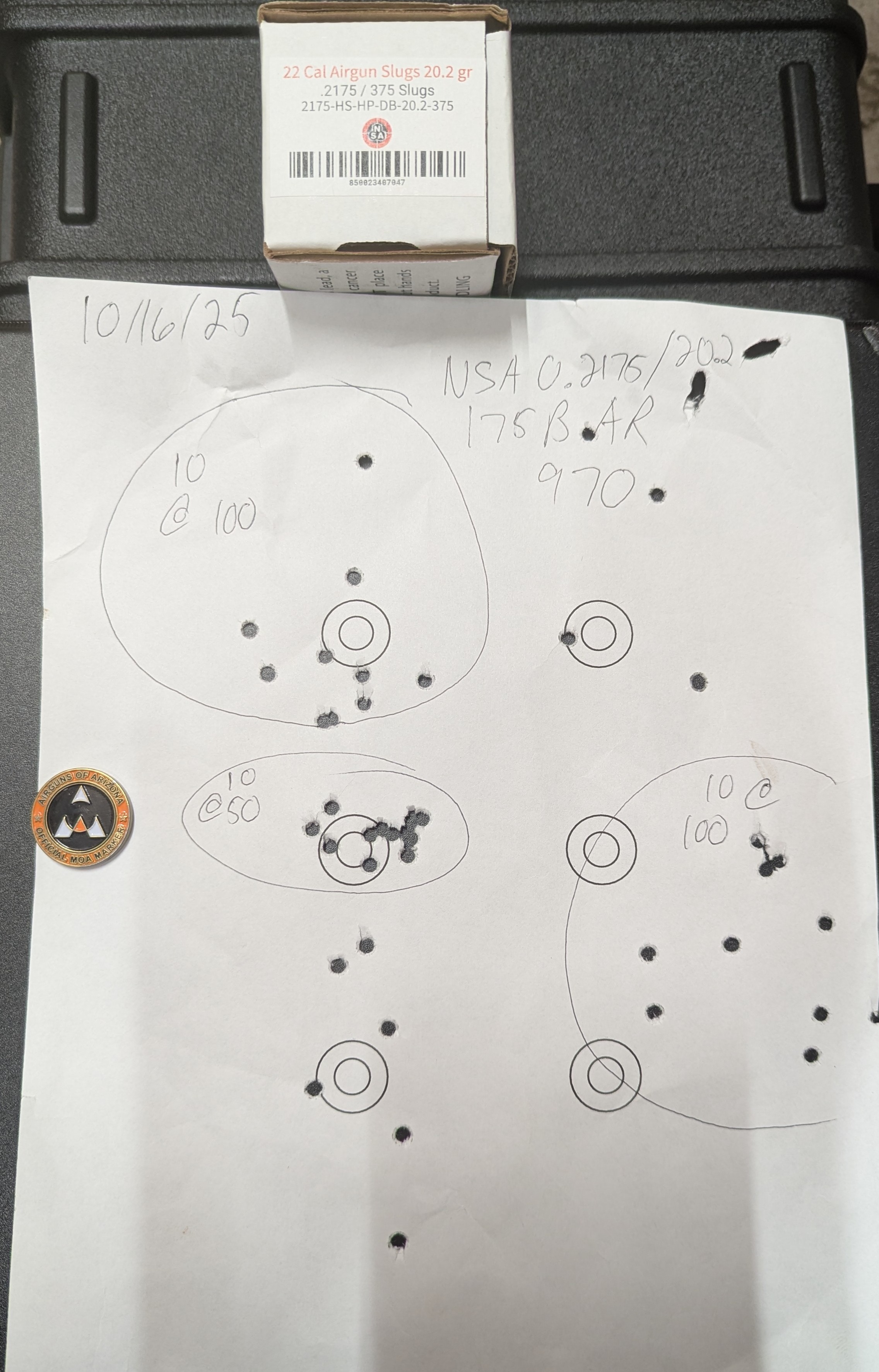

From there I went to yet another not-first choice for a Blackwolf projectile: the NSA 0.22/20.2grain, specifically in the 0.2175 size. More on the size in a second.
Same 175 bar reg pressure as above, same blue hammer spring. same 1:22 SubMOA barrel.
MIN = 960-970fps
"10" = 1107 fps (and yes, sonic crack, I didn't even dare go up to MAX...I'd expect 1200 or maybe even 1250fps)
"5" = 1058
"2" - 1010
Explanation for this target immediately below....Everything at MIN on this page, so 960-970fps Bottom left was sighters for 50 yards-mostly a matter of getting the vertical figured out. Middle left was 10 shots at 50 yards. That measured 1.0625", CTC, fairly decent. So I went out to 100 yards. The top right was the bull used for 100 yard sighters. The seemingly key hole shots up in my handwriting are where the paper curves in my 5 gallon bucket pellet trap.
9/10 in that upper left group are into 1.75" wide and 1.5" tall.
The bottom right group is 2.25" wide and tall.
After that I decided I needed to see if there was any improvement with more speed, the gun is certainly capable of it.
So the next page is 1100fps sighters on the left side. That went poorly at 100 yards so I dialed it back to 1050fpe and shot the upper right group. It's 2 inches tall and not quite 3 inches wide. Which tracks with the right to left wind I was getting. Dialed it back to the 960-970 MIN and shot the bottom right. Similar here, it's got 9/10 into 2 inches wide, and only 1.25 inches tall...wind. (keyhole here is again, the paper curving into the sides of my pellet trap).
Based on the wide spreads I was seeing on the chronograph, I believe this 20.2grain NSA pellet in a 0.218 size would be a much better projectile for this particular barrel. The four different pellets I've tried so far (even the wildly inconsistent in appearance Eun Jins) have had very consistent spreads. THAT, and what the Sub-MOA rep is telling me about their specs for this barrel has me concluding that the 0.2175 slugs were just slightly undersized.
Yeah, both of the projectiles tonight weren't the most obvious choice for the Blackwolf. But I had fun. And there's some potential for those 20.2grain slugs, albeit in a slightly bigger size. I will say that shooting those 20.2s is pretty enjoyable. Very docile. The Blackwolf doesn't even have to try to get them to 960-970. Felt like shooting a single stroke pneumatic, and I'm not kidding.
So, reg pressure is dropped. That 175 bar factory? setting is just too much for what I've tried to shoot so far. Might need a reg pressure that high when I get into shooting the 30-40grain slugs, but certainly don't for everything that I'm shooting so far. On that note, I'm considering tuning WAAAAYYYY down to 800fps with the .22/13.34grain JSB "RS" pellet, and seeing how I can do with it an upcoming field target match. The .22 is always a handicap, but prepping to shoot an ft match, and then doing so, will get me very familiar with the Blackwolf. Of course, if the .177 probe comes from AOA in time, I will gladly shoot it as a .177 (instead of a .22) at that Duncan AZ field target match.

Also, shots were kinda loud. Will state that the Blackwolf, even with this seemingly too high reg pressure, gets more shots per fill than my Ghost set up to shoot the MRDs at the same speeds. I get 35 shots at this same MRD speed from the Ghost with the same 480cc sized bottle. The last 50 shots tonight were on one fill, the last five of which below the reg pressure. So, a solid 45 shots from the Blackwolf. And that shot count will go up when I come down on the reg pressure.
Pretty pleased with tonight's trigger time.
