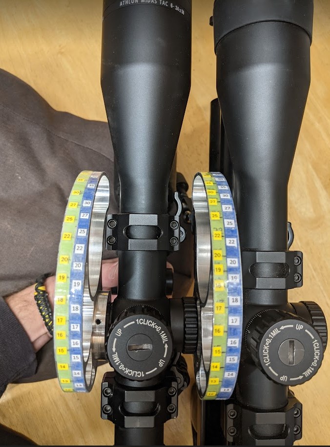

For about a year and a half I've been working towards this final product on the first Midas Tac I picked up, and that grew to include the second one I bought from the classifieds more recently. The goal was to have yardage marks on the sidewheels for both 24x (max) and 16x so that the guns they're mounted on could be shot in Hunter or Open Class. Finally finished it today. Working up the yardage marks on a sidewheel is a pretty tedious process, lay out tape out to 55 yards and then drag something to focus on back and forth along that tape. Best done over multiple sessions with varying angles and amounts of light and a range of temperatures. Also requires a lot of verification of repeatability before the marks are made permanent (I think that's mostly to ease my mind that the finalized marks are trustable). To do it for two scopes at two different magnifications......not fun.
This isn't a tutorial of how I do my scope wheels, more intended as an idea of what the yardage marks look like for anybody considering the Midas for FT.
So, both of them are the Athlon Midas Tac 6-24x50 in MIL, with the APRS2 reticle.
Green background with yellow numbers is the 24x (left side of the wheel) and blue background with white letters is the 16x (right side of the wheel).

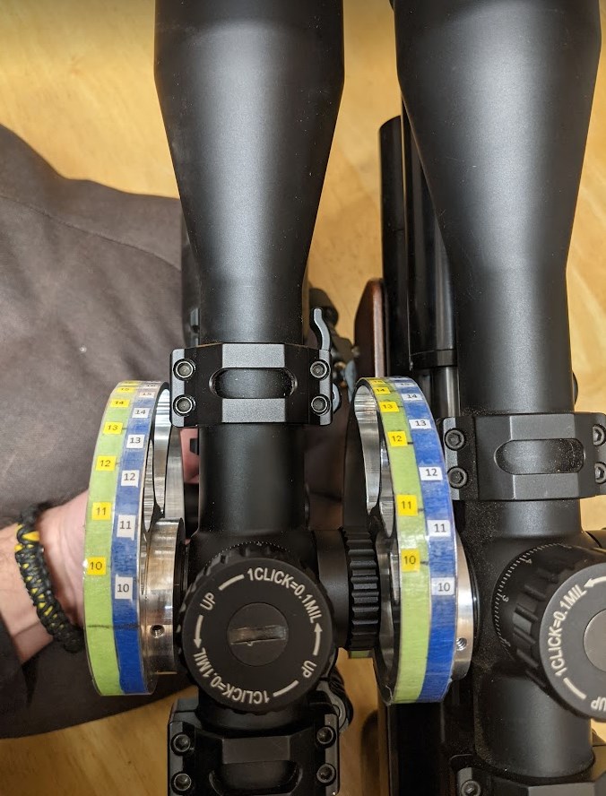

The 3 photos show the minimum, middle, and maximum yardage marks, in the context of 10-55 yards for field target.
Both side wheels are comma shaped.
I was surprised to see that the marks were fairly similar on both scopes. The newer of the two definitely ranges better at 16x than the one I've had longer, but I think the older one is a bit more clear at 24x. They also both focus down closer than 10 yards, reference the first photo and the pencil line all the way across is min wheel travel but the 10 yard marks start a little over half an inch from that mark at 16x and nearly an inch away at 24x. I only made that minimum wheel travel mark on the scope on the left but both display this less than 10 yards min focus attribute.
