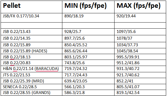

What happens to FPE when nothing is changed but the caliber?
Been curious about the above question for awhile so just used a super windy day to spend some time over a chronograph in the garage.
Ghost with a 17 inch .177 barrel is the baseline. With the 0.047" wire diameter hammer spring and a reg pressure of just shy of 110BAR. MIN and MAX are right in the window of appropriateness for sub20fpe field target.
So, swapped only the barrel, the rest of the settings left the same. An oem 23 inch .22 barrel.
These are the .22 pellets that were tested....
Ranging from 13.43 up to 28.44grains.
And here are the results. The fps listed for the .22 pellets is a three shot average.
Realistically, something in the 15.89 to 21.53grain range is most appropriate for this, if the main desire is to not swap hammer springs or mess with the regulator pressure.
Interesting that on the high end, just the caliber swap (and extra 6 inches of barrel) nets double the fpe.
I've got enough of the 15.89, 18.13, and 20.83 weighted pellets hanging around that I just might do some accuracy testing with them at some future point.
That's wild!!....I didn't expect to see such a fps jump (esp for the 28gr grands) from Min to Max with such a low reg pressure? Thanks for sharing👍
