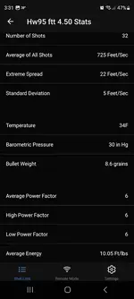

11/11/23
34f, FTT 8.6, 725 fps, ES 22 fps (10 fpe)

And subsequent shots on that same day showed the gun getting even weaker. Life got busy again and I have not re-tested it since November. I expect during the holidays I'll be spending some quality time with it and I'll do more warm and cold weather testing.
My gut feeling is that it might have been tuned with some more traditional lubricants that get thick as the temps drop. My other favorites springer (RWS 34) is one that I "tuned" with a Vortek PG2 kit. That gun has remained pretty stable in cold temps and I know that I was VERY light with any lubricants when adding the kit.
We'll see if this particular gun might benefit from a degreasing and possibly a PG4 kit...

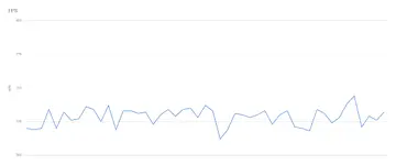

String #1 - 12/25/23
Pellet:
H&H FTT 4.50mm
Temp: 41f (15 minutes for rifle to acclimate to outdoor temp)
Notes: As the gun cools, the velocity drops
Max FPS756Min FPS724Avg FPS741
SD8.21ES32 (4.31%)Avg FPE10.6

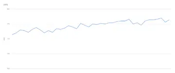

String #2 - 12/25/23
Pellet:
H&H FTT 4.50mm
Temp: 44f (gun acclimated to outdoor temperature)
Notes: More of a spread than I want, but the graph is more or less "level".
Max FPS744Min FPS712Avg FPS728
SD6.54ES32 (4.39%)Avg FPE10.2

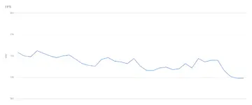

String #3 - 12/26/23
Pellet:
Air Arms 8.4
Notes: OK, this is the next day where I left the gun outside for a couple of hours to make sure it was acclimated to the outdoor temps. I also switched from the H&N FTT pellets to AA pellets which are a little lighter and softer. And I was more than a little surprised that I saw an *increase* in velocity here. (?)
Max FPS785Min FPS757Avg FPS772
SD7.61ES28 (3.62%)Avg FPE11.1

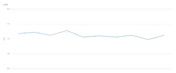

String #4 - 12/26/23
Pellet:
H&H FTT 4.50mm
Temp: 46f (gun acclimated to outdoor temperature)
Notes: This is the last string from that session. I went back to H&N FTT for a short 10-shot string to compare it to the previous day's session. The temps were similar to the previous day, but the gun was shooting stronger. The average fps increased from 728 to 756 as compared to the previous day's "acclimated" average.
Max FPS764Min FPS749Avg FPS756
SD4.28ES15 (1.98%)Avg FPE11.0
